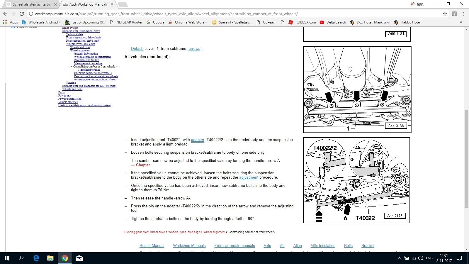

Klik onderin op bjigevoegde bestand links onderin om geheel oorspronkelijke info uit te vergroten.
ja bij Koop9  zit je dan goed..... voor die info
http://workshop-manuals.com/audi/a2/run ... nt_wheels/
tekst <table><tbody><tr><td><table><tbody><tr><td>Centralising camber at front wheels</td></tr></tbody></table><table><tbody><tr><td>Special tools and workshop equipment required</td></tr></tbody></table></td><td> </td><td> </td></tr></tbody></table><table><tbody><tr><td><table><tbody><tr><td>t </td><td>Adjusting tool -T40022-</td></tr></tbody></table>Afbeelding  Note!<table><tbody><tr><td>Move the subframe only to the left or right (viewed in the direction of travel) and never forwards or backwards.</td></tr></tbody></table><table><tbody><tr><td>– </td><td>Remove noise insulation.</td></tr></tbody></table><table><tbody><tr><td>Vehicles with 1.2 TDI running gear</td></tr></tbody></table></td><td> </td><td>Afbeelding</td></tr></tbody></table><table><tbody><tr><td><table><tbody><tr><td>– </td><td>Detach cover -1- from subframe -arrows-.</td></tr></tbody></table><table><tbody><tr><td>All vehicles (continued):</td></tr></tbody></table></td><td> </td><td>Afbeelding</td></tr></tbody></table><table><tbody><tr><td><table><tbody><tr><td>– </td><td>Insert adjusting tool -T40022- with adapter -T40022/2- into the underbody and the suspension bracket and apply a light preload.</td></tr></tbody></table><table><tbody><tr><td>– </td><td>Loosen bolts securing suspension bracket/subframe to body on one side only.</td></tr></tbody></table><table><tbody><tr><td>– </td><td>The camber can now be adjusted to the specified value by turning the handle -arrow A-<a rel="nofollow" target="_blank" href="http://ctrl:IDREF=idp47472/">→ Chapter</a>.</td></tr></tbody></table><table><tbody><tr><td>– </td><td>If the specified value cannot be achieved, loosen the bolts securing the suspension bracket/subframe to the body on the other side and repeat the adjustment procedure.</td></tr></tbody></table><table><tbody><tr><td>– </td><td>Once the specified value has been achieved, insert new subframe bolts into the body and tighten them to 70 Nm.</td></tr></tbody></table><table><tbody><tr><td>– </td><td>Then release the handle -arrow A-.</td></tr></tbody></table><table><tbody><tr><td>– </td><td>Press the pin on the adapter -T40022/2- in the direction of the arrow and remove the adjusting tool.</td></tr></tbody></table><table><tbody><tr><td>– </td><td>Tighten the subframe bolts on the body by turning through a further 90°.</td></tr></tbody></table></td></tr></tbody></table>

Rolf, bedankt voor je duidelijkheid in deze, hier kan ik zeker wat mee.
Weet nu waarom beide uitlijn bedrijven niets konden aftellen i.v.m. speciale tool!
Ik ga zeker contact opnemen met mijn dealer omdat in orde te maken.
